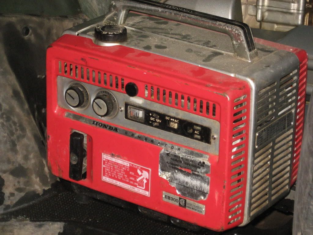

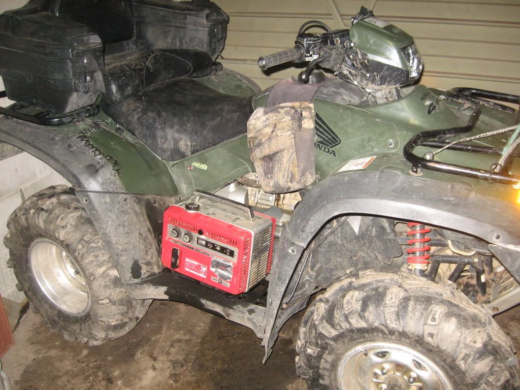

Keep us posted..synthetic oil is superior to regular oil everybody knows that but is the $$ worth it? maybe... but im still sitin on the fence. I like to think my honda motor with fresh oil every 100hrs will out live the rest of the machine. btw i still own one of them 300w 1960 something HONDA generators that im taking on my quad trip tomorrow..it runs a sony stereo and a light.B)
Get out... those things look wild. My buddies dad has one.... we found it in his barn under about 4' of garbage and hay.... put gas in it and the sumbitch started right up...... We took it out in the field to run a metabo to cut a Dana44 out from under a an old comanche haha.
in the footwell of my 06 rubi..:lol:the wet mess under it is from oil change mishap on rubi..dam dog tail hit the funnel when i wasnt watching

Dude, thats the same one!
