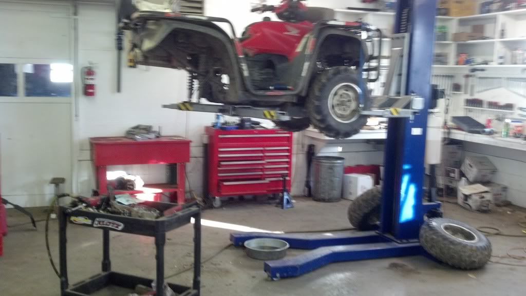

#17 ·
Makes me wish Santa would bring me a machine lift like that.
No kidding... Thats the cats a$$.. I could even fit another quad in my garage if i stored one on the lift and the other under...Hmmm. lol B)
