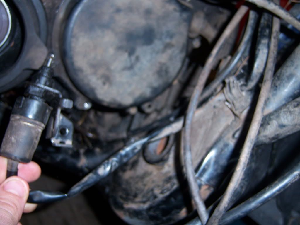

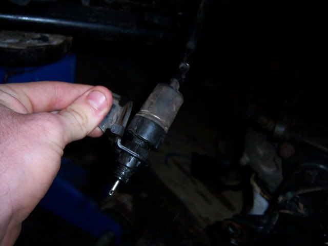

Ok, so here are some pics I got today.
Here is the part...
<a href="http://i233.photobucket.com/albums/ee11" target="_blank">http://i233.photobucket.com/albums/ee11 ... 1194878599</a>
Here is the wire...
<a href="http://i233.photobucket.com/albums/ee11" target="_blank">http://i233.photobucket.com/albums/ee11 ... 1194878625</a>

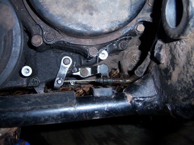

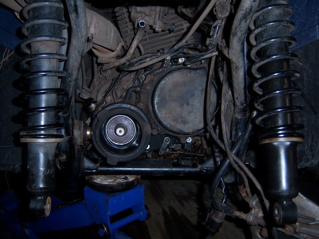

Here is my case cover with the stater back on and such...
<a href="http://i233.photobucket.com/albums/ee11" target="_blank">http://i233.photobucket.com/albums/ee11 ... 1194878726</a>
<a href="http://i233.photobucket.com/albums/ee11" target="_blank">http://i233.photobucket.com/albums/ee11 ... 1194878744</a>
I havn't found a hole that this fits in or screws into. I feel stupid because this must be so obvious.
The picture is the rear brake light switch ...
Oops.
Thank you!
