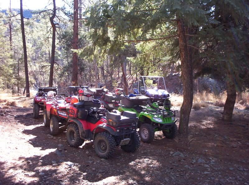

Here is a picture of My Bighorns last weekend
with over 3000 miles on them
90% of my riding is just like Yours
The sidewalls of the Horn's have helped save my
cast wheels,and I drive over what most people
drive around !
I also have a buddy who put 26X9X12 in the front
and 26X12X12 in the rear without any issues on
his '03 Foreman 450
IMO,Bighorns are the way to GO !

Here is a better picture of My Buddy's
Foreman with the Horn's
