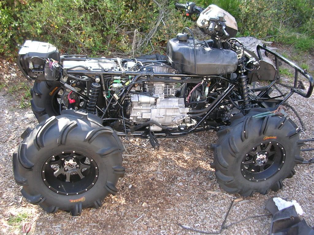

I was having problems with my ES shifting so I striped mine down and dielectric greased every electrical connection on it. When I was greasing them I found a few with water and corrosion in them cleaned them out and now no more problems.
The green connector on the right in this pic was the one causing my problems.
