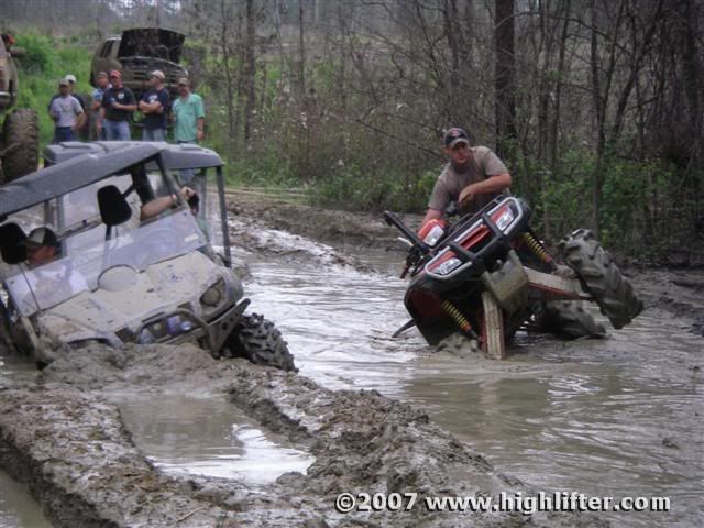

I chose to snorkle my exhaust for that exact reason. We ride in some of the deepest and most crazy holes. Sometimes its tough to just stay on the bike never mind keep the throttle hammered constantly.

hey tbryant, looking at your bike and reading what you said about not being able to hold on...makes me want to see some pics of the junk you put your bike through...share the wealth my man, lets see some pics.
QUOTE ("cra5h":2b8igizj)
Heres one. These ruts only got deeper...Check out the size of the trucks (in the background) I ride with. Riding with them...you come across a deep hole or two.
nice.. tybrant.
**** cuz if u get that thing sunk you need to invest in a **** submarine that thing is awesome!!!!!! so what does a lift like that usually run???
that lift he custom made him self along with his independant rear suspention
