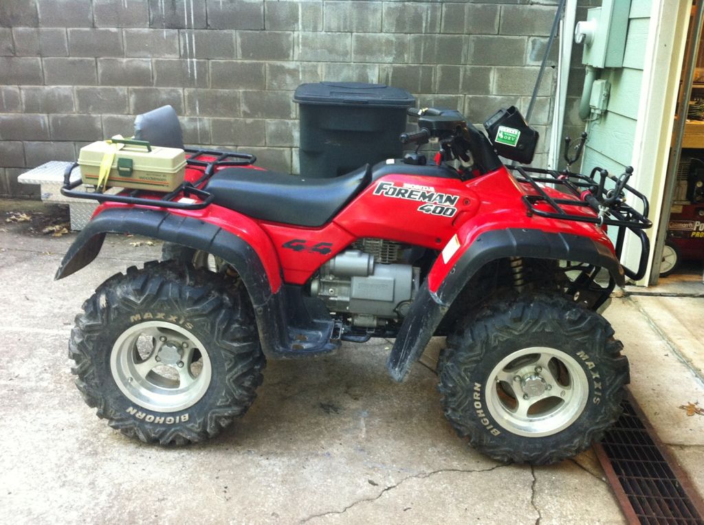

Hey guys, I'm new here, picked up a 1998 Foreman 400 a month or two back and have been lurking here for tips and tricks. Its got about 1400 miles and 230 hours on it and is in pretty good shape. Had the bigfoot package installed at Honda when bought with those dang expensive Maxxis tires on it, glad there is still a lot of life in em! Here it is on the day I brought it home and out playing:

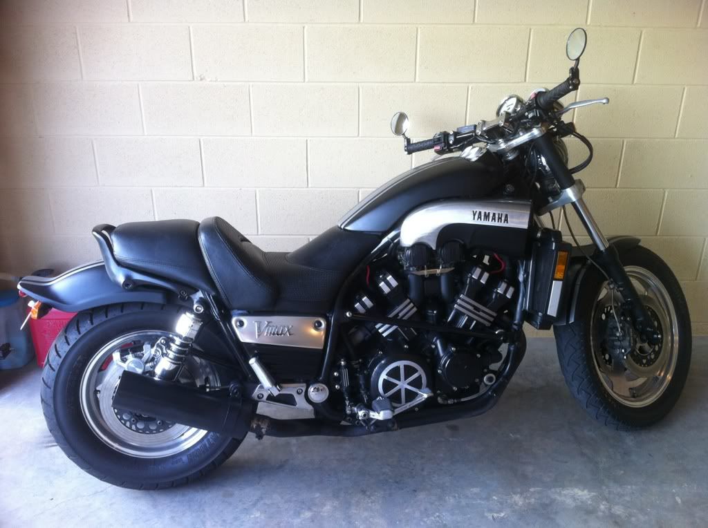

I got this because I wanted something to putz around on with the wife and little girl. Before the little one came around we spent a lot of quality time on the Vmax, but it doesn't seat three real well so we needed something different. Just because I love my bike still, here it is:

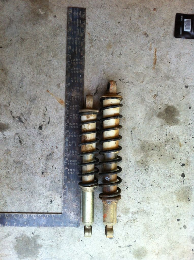

So, cause we ride 2.5 up most of the time, we were dragging over fallen tree, etc. a lot on the trails. So, I figured a small lift was in order. I didn't really like the look of the bracket lifts, so after some research on here decided to pursue the 450 shock swap. Found a set on ebay and gave em an offer of $30 shipped and they took it. Pulled the rear first and here is a shot comparing the 400 to the 450 (right at 2" longer eye to eye, perspective is funny, but the bottom of the square is in the center of the eye):

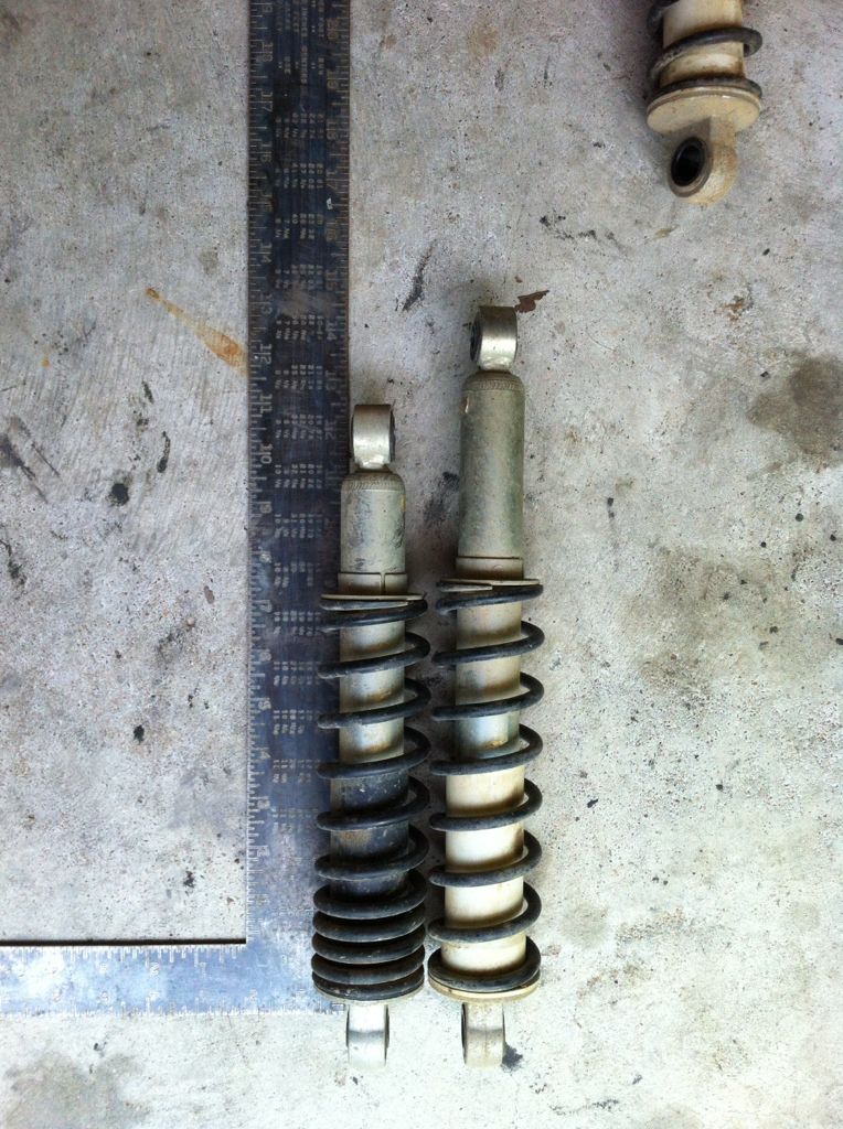

The rears swapped out easily without any modifications or grinding. I did have to take the bolts holding the muffler to the frame out to give me some more wiggle room, but nothing difficult. Moved around to the front, pulled the stock shock and compared it to the stock rear which was taking its place, again about 2" longer:

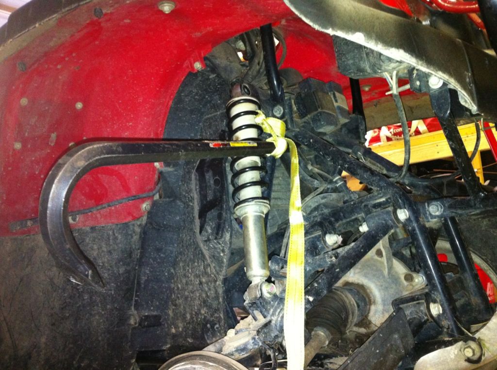

You have to press out (I used my vise) the rubber upper sleeved bushings from the shock eyes and switch them in order to get the rear to work in the front and have the stock upper bolt fit tight. No grinding was required for the swap and they fit right side up. Now, with the A-arm fully drooped, you will not be able to squeeze the rear shock into the front slots with compressing it. So, I bolted the bottom in, then rigged this contraption of a crowbar and some webbing together to pry against the frame to get the upper shock eye to set into the upper cup:

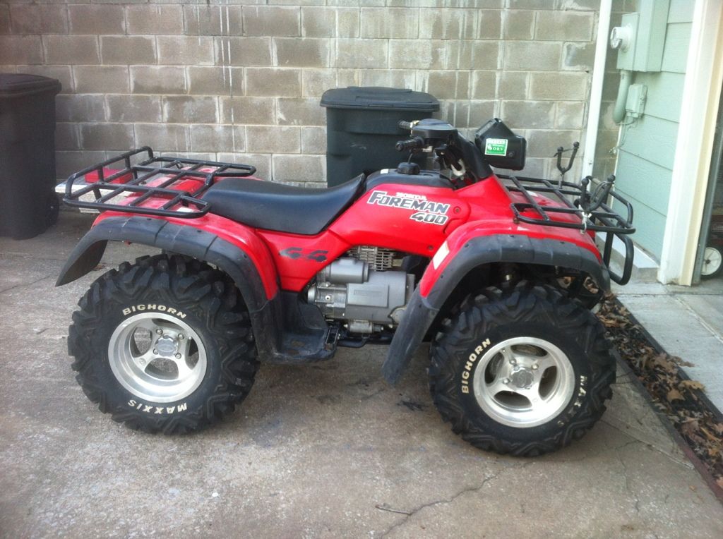

Worked pretty well actually. Then I used a screwdriver wedged between the upper eye and the top of the bucket it sits in to compress the shock a bit to get the bolt and hole to line up. Now she sits pretty level and a fully loaded shakedown ride reveals no front axle noise and relative comfort. I put the frame about 2-3" higher off the ground after this swap. I made the ultimate mistake and didn't measure before hand... :wacko:
But, I had another before picture and so I took an after from the same angle.
BEFORE:
AFTER:
