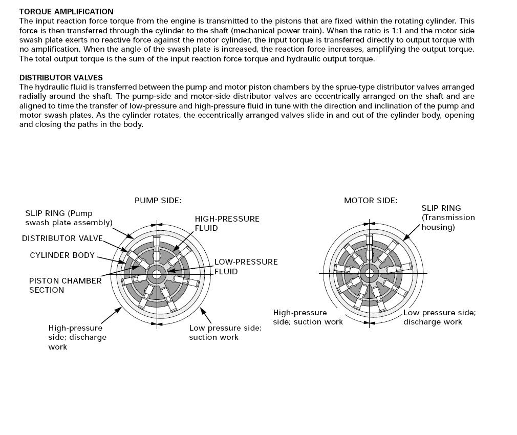

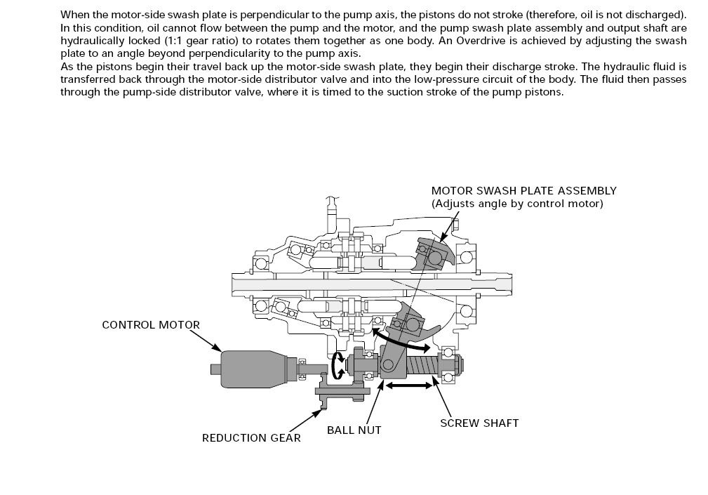

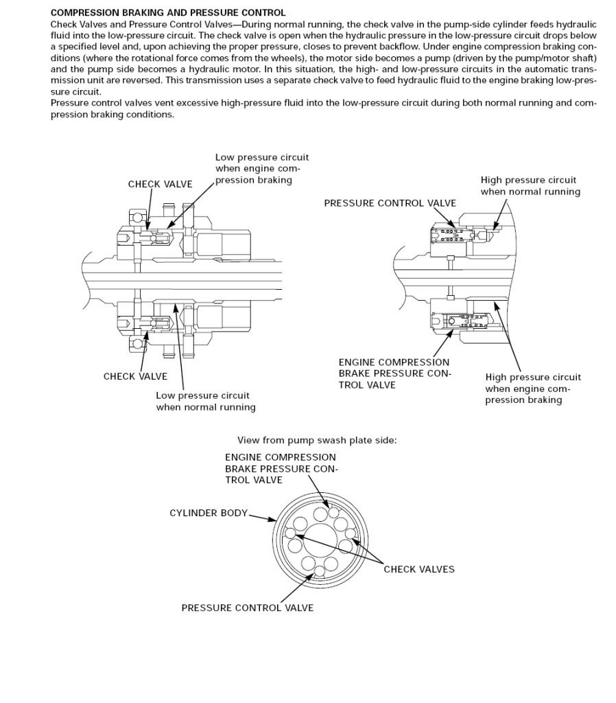

where do you get these diaghrams and info from?

Service manuals mostly.

You get that kind of info from one of these.
I bought this one the day I bought I bought my Rubicon.
I found it to be very interesting reading and very educational.
